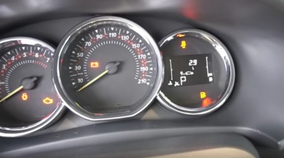

effesse72 napisał/a:
Now I have to study hard for implement the Temp of Coolant of Engine (I don't like the little vertical bars)
Is this your picture? This screen is inactive in our Dacias. I would like to know how to enable this vertical indicator ... There is such an option in DDT4ALL, but unfortunately it is also inactive.

Wysłany: 2020-01-26, 17:58
Now I have to study hard for implement the Temp of Coolant of Engine (I don't like the little vertical bars) and 4WD Inclination Data, if it will be possible ;-)
4x4 indications will not be in Sandero. Only Duster has the module needed to read the slope
Yes Dymek, it is my car ;-) see this link for trying your-self , keep ENABLED the best Antivirus you have!

Wysłany: 2020-01-26, 20:22
effesse72 thanks, it works in Lodgy.

Wysłany: 2020-01-26, 21:31
Ciekawostka, przejechałem 8km w jedną wyjeżdżając z +15st. C, 20min postoju, 8km w drugą i więcej niż 3 kreski się nie pokazało.
Pomógł: 123 razy
Posty: 4184
Wysłany: 2020-01-26, 21:57
buladag napisał/a:
Zgodnie z opisem nie powinno być więcej niż 3 kreski, skoro mamy montowane termostaty na zakres poniżej 90 stopni.
