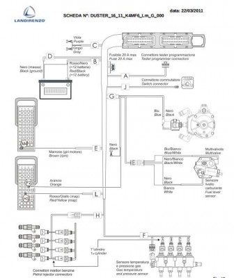

only 3 new cable to sensors original
M4 revolutions per minute
F2 water temperature
H3 intake manifold pressure
http://www.stara.landi.pl...RE184%20_PL.pdf

Sensor are installed but not connected ? :lol:
Ok i understand where to connected cables in the driver cube but where are this sensor ?

LPG factory installation - between petrol ECU and LPG LC02 canLine ECU transmission of information rpm, map, watertemperature on digital connection (canbus)
for freely programmable LPG ECU
http://allegro.pl/opel-co...5066065691.html
need analog connection how to images show you
connection plan LPG plug
petrol ECU F2 water to LC02 Pin 33
petrol ECU H3 map to LC02 Pin 36
petrol ECU M4 Rrpm to LC02 Pin 42
optional
petrol ECU B1 lambda to LC02 Pin 13
original LPG ecu can you at any time back plug and play

heh i just dont get that i have to connect car ECU with LPG driver .
I think i will have to connect directly to lambda or temperature sensor . Now it looks more easier.
You said that
optional
why its optional ?

Wysłany: 2015-04-16, 20:40
Karenzo napisał/a:
why its optional ?
is only for Display value of lambda voltage in the diagnostic software LPG
water temperature and map is also not compellingly necessary, but better if available
