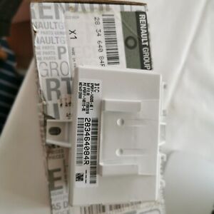

  Wysłany: 2020-01-05, 19:14   283464084R and Sandero Stepway Techroad 1.5 Blue dCi of 2019
Good morning dear all and Happy New Year 2020 to all of you! Just to tell to the Foum that I hope I did deals with the purchase of a used BIC 283464084R from eBay. Now I'm checking cables and wirings to the connector with 24 pin and the ODB2 port. The BIC wasn't still delivered to me so I hope that it will be good until of the end of the long trip. Best regards and HAPPY NEW YEAR again !!!

effesse72 napisał/a:
Just to tell to the Foum that I hope I did deals with the purchase of a used BIC 283464084R from eBay...
I have the same BIC module in my Sandero. Works without any modifications.

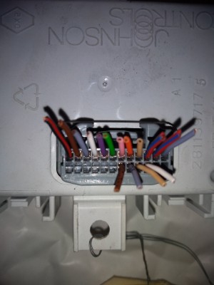

Miałby ktoś może na zbyciu BIC z "wiązką" zakończoną wtyczką OBD tak jak ktoś tam wyżej oferował?

Thank you very much Dymek for this confirmation, I'm working on wiring the 24 pin
connector with the OBD2 port in the glove box (actually with wires exit on the rear)
because my Stepway is from Dec, 2019 so I don't want to see lost the 5 years of warranty.
...my Stepway is from Dec, 2019 so I don't want to see lost the 5 years of warranty.
You can solder the wires away from the OBD socket and isolate the wiring harness as it was originally. Then hide the cable and BIC module high under the dashboard. Nobody will find it. We also have cars under warranty and we make various modifications.
